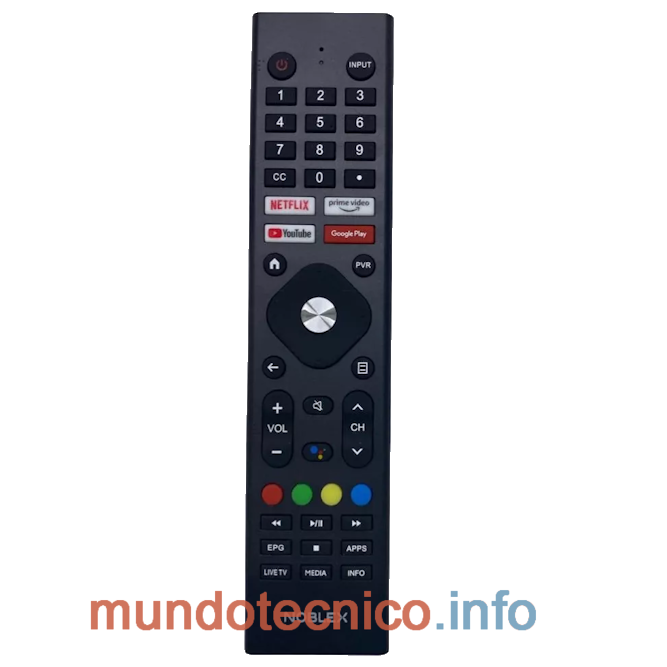

TP.MT9216.PB705 - Control Remoto
Control remoto modelo TP.MT9216.PB705 correspondiente al Chasis TP.MT9216.PB705.
