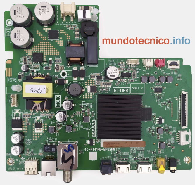

Empresa: TCL
Modelo: L32S6500
Chasis: RT41PB-AG
Control Remoto: RC802V / RC802N
Wifi: 07-8192BT-MA1G
MainBoard+PowerBoard: 40-RT41PB-MPB2HG <-- Link más información!
Project ID: 019 (Panel 08-32F6000-LPM001I)
Project ID: 081 (Panel 08-32F6000-LPM010J)
Manual_Usuario_L32S6500.pdf
Manual_Service_L32S6500 <-- Link de Descarga!
  • TCL LVW320NDEL CJ9W02 V14 (08-32F6000-LPM001I)
    CSOT ST3151A05-8 CELL, 1366×768(RGB) LVDS (1 ch, 8-bit) 12.0V 0.22A LVDS-30P1C8B-015C
  • TCL LVW320NDEL CJ9W19 V10 (08-32F6000-LPM010J)
    CSOT ST3151A07-2 CELL, 1366×768(RGB) LVDS (1 ch, 8-bit) 12.0V 0.39A
